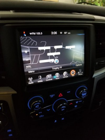

Wanted to post my experience performing an upgrade from my RA2 to the RA4 8.4AN uConnect/Nav. There are a few options, you can source the individual parts and put the package together yourself, or you can purchase a ready to install kit with everything you need, which is the way I went. I bougth the RA4 upgrade kit from infotainment.
There are three options, no nav, basic nav, and 3D nav plus HD and extra SiriusXM goodies. I went ahead and went the the upper tier 3D/HD package - figured if I was going to spend this much I might as well go all the way. The price currently ranges from 1200 to 1600 depending on which unit you choose. (don't freak just yet, more price info below)
Package includes head unit, replacement bezel, HVAC controller and cable, and 911 plug. All parts looked new. The head units are reconditioned units with 90-day warranty, with a 1 year option available. This is the kit for the 7 speed fan, and upgrades you to the nicer controls also.

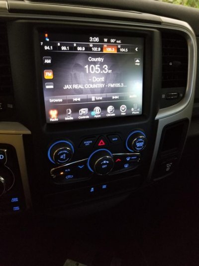

Since we are both in FL, it arrived quickly, and within an hour pretty much I was done. It's a very simple install, really. Disconnect battery, mount the HVAC controller, route cable, pull bezel/radio/plugs, swap bezel, mount new unit and replace plugs, reconnect battery. That's it - you'll need to transfer Sat service over to the new radio ID, and may need to drive around the block to calibrate the NAV, but otherwise you are basically done. I stopped for a few minutes as I cut my finger pretty good routing the HVAC cable so it's basically an hour or less. The only minor issue I ran into is that the main harness for the radio the wires come out and bend one direction - when swapping the radio those wires were set in that bend which prevented really getting a bite with the lever to latch it in, so you just swap the lever to the other side (so you are not fighting the bundle of wires) and it drops right in.

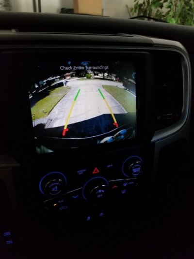

As advertised, everything works as expected. Nav directions display in cluster, steering wheel controls all work, you can use touch or manual controls for radio, HVAC, etc. Backup camera is so much nicer on the 8.4" vs the 5". Then there's HD Radio and SXM Travel/Traffic. I haven't messed with HD Radio but did at the Travel/Traffic to my Sirius account and it's easily worth $5 a month.
