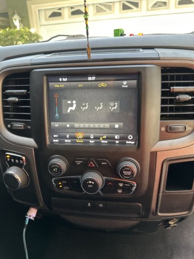

I have a 2017 1500 single cab and kept my three knob heat/ac controls but added stering wheel audio controls from dealership for around $250.you can buy the parts and do yourself but when installing you have to remove stering wheel air bag so i let dealer do that.now i can control uconect from stering wheel controls.Also,I originaly had just am fm radio that came with truck.I purchased the 8.4 faceplate with just one volume control so i would not have to change the ac config that came with truck.After lots of research and videos,I have paired it with 2013 uconect 8.4 with gps ,hd radio and more .
This setup has worked flawlessly for over 7 years.
