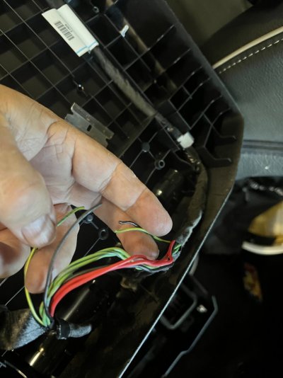

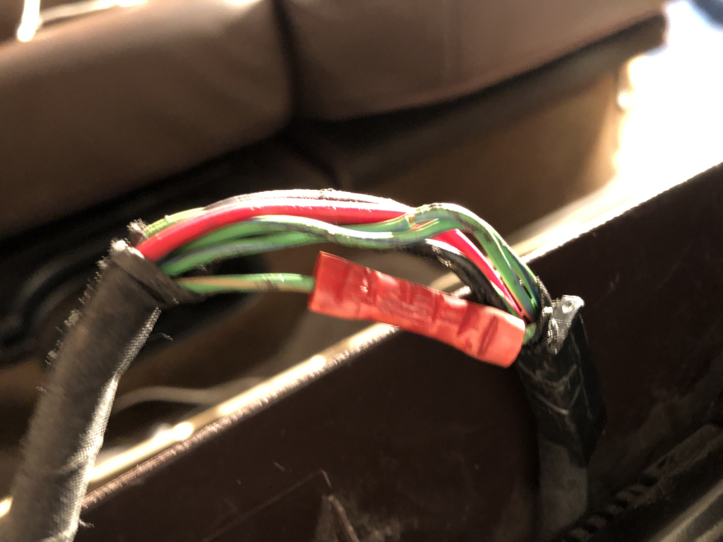

So I had this same issue and fixed it today. The problem is that the wire harness is so tight that when you open and close the center console the wires are being pinched. One of my wires was completely severed. That was an easy fix with a butt connector joining the 2 wire together again. It's not difficult to get to. In the top tray where the aux, usb, power, etc is, lift the rubber mat exposing 7 #10 torx screws. Remove those. There are another 5 #10 torx screws on the padded armrest. Remove those and set the armrest aside. From the backseat, remove the panel for the rear seat controls.......it just unsnaps from the bottom corners. There you will see the wire harness that gets pinched. Open up the harness to reveal pinched or broken wire. I removed the connector from it's mount to free up some cable so it would not be so tight. Used a butt connector to rejoin wires and electrical tape to seal up the job. Now that the cable is loose because I released the connector from it's mount it slides freely when opening and closing the center console and no longer pinching the wires. You could solder them back together if you don't want to use a butt connector.

Had this issue after Ram dealer replaced fried Uconnect, your post pointed me right to the issue!! Undid the taped bundle of wire at the hinge point and the green/blue and green/yellow wires were completely severed and the black hanging on by a strand or two. Spliced, soldered and shrink wrapped and reassembled console lid and good to go. Thank you @freelance for your write up!!!

Thank you so much for this post. I actually found it a couple of years ago, but never fixed the problem, I just worked around it. I finally broke into it today and found two wires cut completely through. Thanks again
