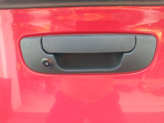

Like this?

What is it? Do you like it? Where did you get it? That looks it might be exactly what my truck needs.
Android head unit with an OEM looking backup cam. Put these in my old 03 along with a power tailgate lock. All three pieces are for sale.
