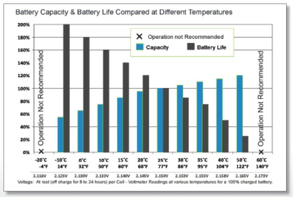

Cold preserves battery but kills capacity, of which is important to a hemi. So regardless change battery the capacity is low and move on from there. It's time anyway, so you lose nothing. If you lived in a warm state you would have changed it years ago.
