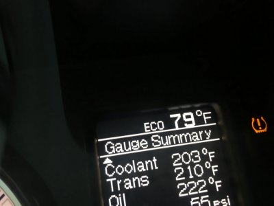

17 ram 2500hd 6.4l truck was at the shop for a few days they said the tires caused the balance body to go (not sure but it’s covered) got the the key back with the new bosy installed 80 mikes later trans is over heated yet again now they blame the mufflex muffler delete. Any ideas what’s causing 210-260* trans temps?

Aside from the coolant being a little high for an unloadedtruck, the other two look hot to me, but I am basing that off of my truck. I have no idea what normal temps are for the 6.4L.
The other #'s are OK. Here's mine on a normal day. Once it's warm, outside temps don't affect it too much. These numbers are common on a 6.4.c25e52b5575222a7d44f7e5b8d070dff.jpg
I concur, this is what my 6.4L reads as well on a normal warmed up summer day.......that trans temp is pretty damn stable at 168-175 even when I am towing, including 90+ degree days.....and hills etc.
For an unloaded rig to be sitting at 210+ all day......something is ferked up, and it ain't the friggin' muffler.....
