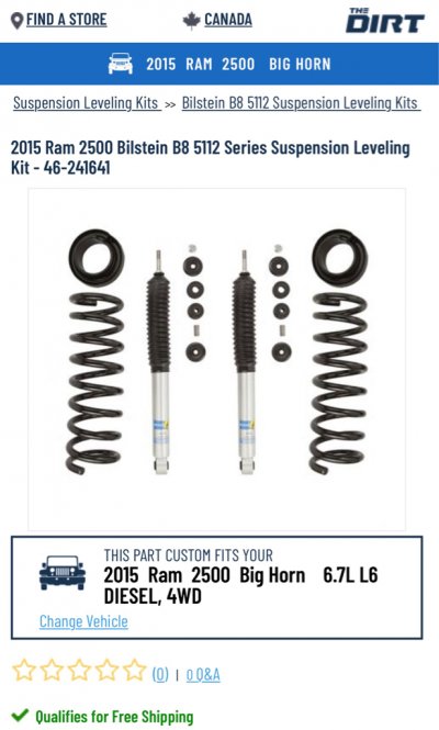

What was in the Bilstein kit?
What parts did you change.
Bennutts
Bennutts
Oct 2, 2015
81
15
Cummins 6.7
New shocks all the way around and springs in the front.
