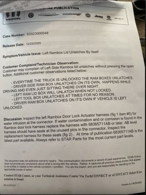

Interesting issue with ram box door. Left side will open automatically if doors are unlocked. Unlock doors wait a minute or two and pop. So right now I have a beautiful 60k truck with a piece of blue tape holding down ram door. Love the truck but we’ll see the cause next week. I always video tape issues so when I bring the truck in I’m not looked like I’m cray. I began the practice with my 19 with many u connect issues

I responded to another thread about this. Here's that response:
There is a TSB for that. I saw it in another 5th gen forum. Pretty sure it involved replacing the wire harness for the affected rambox lid. Something about water damage. Here's what I dug up after a quick search...
