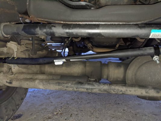

I ended up needing a new Drag Link after sliding into a curb and bending my OEM unit.
It had the Recall welds done to it prior to it bending.
I didn't have the time to do a Synergy Link myself so I took it to my mechanic, He had to go to the dealership for the part and this is the new unit being installed. It has a flattened section in the center that threw me off for a minute.

View attachment 483628View attachment 483629

Might be a dumb question but does it matter if the drag link is mounted on top or bottom at the pitman arm? I put on a synergy one a month ago and it says to mount it on top of the pitman arm which is how my stock one was mounted on my 16.

That's exactly how the OEM OEM replacment on my 17 looks. Nice!
It only mounts 1 way, from the top (it's tapered). The guy above must have a aftermarket drop pitman arm.
