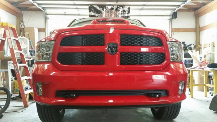

Does anyone know 100% if this grill would fit on a 14 Ram Express ?
My truck :

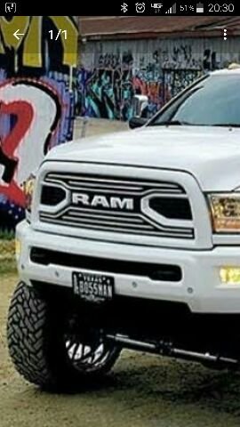

And the grill I'd like to paint to match and install on my 14 Ram QC Express :
Thanks for your input !

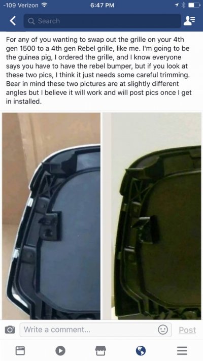

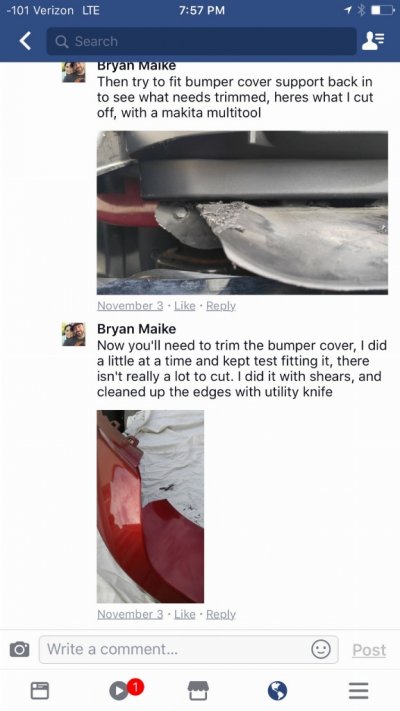

It rebel grille won't fit unless you trim the bumper and grille.

b9dfc8b95e862c91786798c20b94c0ed.jpgcb9121f388d309c4abd20653e01bca76.jpg401f7661aee746ee445004c2192db397.jpgdc3fcd8a6d1e4c6bbd255b33ba78e8c3.jpg

I just figured out the white one above isn't a rebel grill , hmm maybe it's an eBay replica ...

The pictures are from Bryan (a forum never that posted previously). His pictures and info were awesome and guided me during my install for my sport.

The white one is from a heavy duty Laramie or maybe Laramie limited.....so basically you want a 1500 limited grill which would then require no trimming

09-12 have different front clips than 13-17.. notice the bottom angles.. 2500 and up have grills like 09-12
