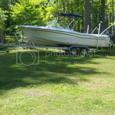

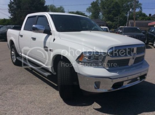

I am looking to purchase a 2015 Longhorn, 5.7, 4WD, 8 speed, 3.21 rear end. The description on the dealer website shows "Towing w/Harness and Trailer Sway Control" I see that it is rated to tow 7790 lbs. My boat weighs about 6000 lbs on a tandem axle trailer with surge brakes both axles, (SC law). I had a 5.3L Suburban that I pulled with but the 3.21 is a tall gear. I like the truck but would like some opinions from owners with this setup and towing.

So I can pull 6000 lbs OK? Funny thing, I am driving a 2WD Ram rental now and I hooked up to the boat, the trailer wheel was in a hole so all the truck did was spin in the grass. I hooked up our old 1989 350 4WD Suburban with 250,000 miles and it pulled it right out. Gotta have 4WD.
