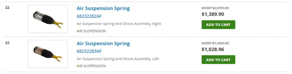

Good call oe542bob! I went back to the site, and used my VIN instead of of selecting model. This time, it showed additional parts numbers for the air struts.
68232282AF (Right side) and 68232283AF (Left side)
