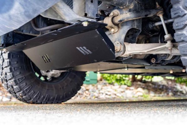

There's this skidplate from Coastal Offroad which mounts to those crash compatibility brackets.
It's part of a full kit, I don't know if they sell parts individually but the kit looks pretty comprehensive.

Pretty easy to make your own with a grinder and a piece of steel

Actually I found dimensions for the plates shown above. I started building it yesterday. I’ll post pics when I get it finished. I’m planning on building it a little better and bulletproof. Thanks for the help fellas

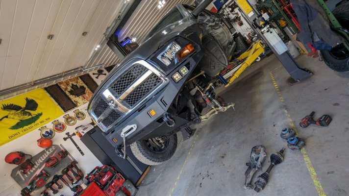

I made my own bash plate, Out of 1/4" of course :headbang:
Dont forget to add some reliefs at the bottom for mud and water to escape. ;)
I also cut those stupid crash mounts off that extend off the frame. Cut off the front cab mount and moved it up 3" and welded em' back on :cool: thats the only way i found to clean up the front end properly so I wouldn't see that awful ****.
