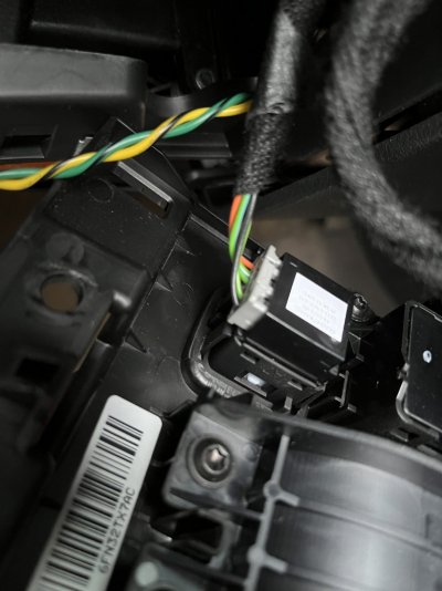

Hi,
I dont have any power on the 115v plug in the Rambox.
When I connect my 115v to 12v adaptor in the 115v plug in the plug in the passenger part it does work.
The cause is most like that I dont havre wiring going to the on/off switch in my dash??!!
Could someone post a picture of which wiring part should plug into that switch?
On which loom does the wiring connect?

Just found it myself!
The tape around the cable must have stuck during production as it was stuck 10cm above the plug itself.
I removed the panel in which the switch was located and looked around when i noticed the plug.
Now it all works :)
