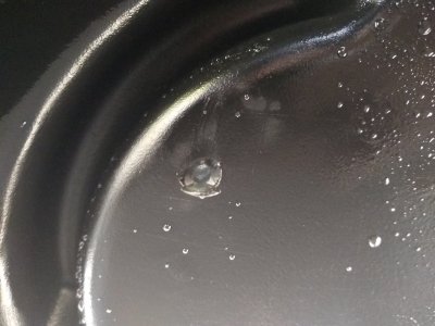

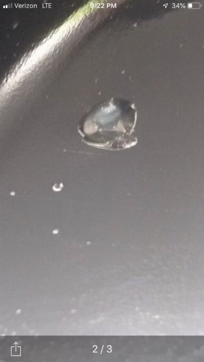

Want to get in my truck this morning and noticed a gas smell. Didn't really think anything of it as I had just walked past the gas cans for the lawnmower and dirtbikes figured maybe one of the lids got left off. Pull out of the driveway and in my rearview mirror notice a puddle where my truck was sitting. Get out and look and sure enough it had a semi circle chunk broke free. I'm sure I didn't hit anything as the tank is free of any scuffs or dings. It almost looks like one of the casting injection spots just randomly blew out. I'm about 99.9% they aren't going to warranty it but should I try anyways or am I just out the $600 Dodge wants it's for a new one.

Looks like something took a hard road bounce into your tank.

Doesn't seem likely to me either but it's clear that's impact damage in the last pic.

That puncture is almost perfectly round. Somthing fishy happened here

OPs third pic almost looks like someone started to drill the tank with a pilot point bit and stopped.
buddy of mine had a 6.4 2500 military vehicle they were using on a job in Oregon. someone drilled the tank for gas. so it does happen.

Looks like its countersunk, like it punched out, vs in
Definitely what I was thinking. kind of hard to tell from the pictures but the little flap that blew out is still there and you can like lay it over and it perfectly fits in there no way was that a puncture from something as it should have poked in not out and it's definitely not from a drill bit because the little flap is there it's almost like the plastic was defective when they cast it and just popped out

I agree that as unlikely as it is... it looks to me like it came from the inside out.
