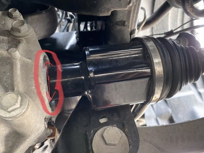

I’ve been chasing a rattle from the front end of my 2020 1500 with 3.5 ready lift. I changed sway bar links. Torqued struts etc. Today I looked at front half shaft/cv’s. I do understand they should have a little horizontal play in and out of front diff but how much play from up and down or front to back should there be. Can someone please check their truck?! Thanks!

This is the direction of play that doesn’t seem normal

I changed strut to Bilsteins. I didn’t find anything wrong with cv. I think one rattle was from strut studs poking through the top hat spacers rattling on strut pockets in engine compartment.

Lift kit is hard on CVs. So the Dealer has every right to play the blame game...lol...

I have the same issue. Not lifted though. I replaced the CV axles and the inner axles. They were quiet for about 1,500 miles. Now clanking again.
