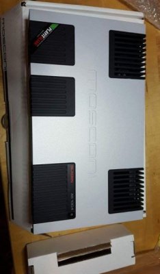

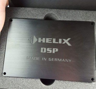

Sexy! Those are some of the prettiest things in the car audio world (not to mention made in Germany), the mosconi isn't bad either, lol! ;)
Lol thanks David. So when ya going to buy my one series amp [emoji12]
Sent from my SM-G920V using Tapatalk
Read my audio related post in my Holding Back the Tears thread... I'll be talking to you...
