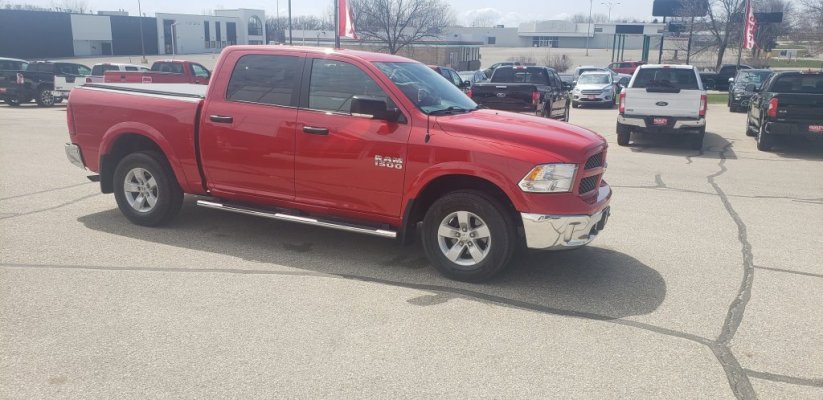

So I am considering a trip to look at the 2016. It is an outdoorsman with 65K miles with factory 17" tire setup. Per a gear ratio calculation the 17" tires with the 3.55 gear set would give the greatest mechanical advantage. At 75 MPH, rpms would be 1900 in 8th 2400 in 7th which from my experience is a good spot for the pentastar for cruising. As far as towing 6th gear would be 2200-2400 between 65 and 70mph.
I now from personal experience in my 2012 DGC that I have pulled 2000 pounds with the engine in 5th (1:1) and it just played with the trailer and weight. Maybe It would be better than what I think...
