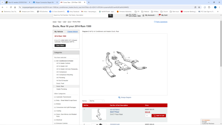

Quad cabs don't come from the factory with rear air. To add rear air you would need several different ducts. Screenshot (216).png
