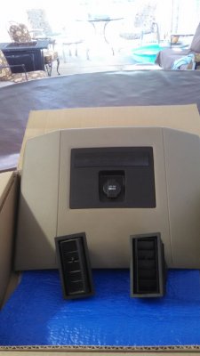

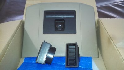

If this helps anyone I have my stock rear console cover for sale on e-bay..BUT I also have 2 ducts I was going to install in it that I found in my tool box (I'm a fleet mechanic ). My original plan was just to mount the 2 ducts and put a quiet small computer fan behind them..they run off 12v and are totally quiet and would recirculate the air like a fan. Anyway I decided to go factory after finding the rear cover with the A/C vents already in it. If somebody wants to try and mod it to work...this way you can cut and mod my old one and if you have no luck you'll still have your original one...40 bucks and you can have it all..I have just the cover on e-bay for 50 and shipping...if a member here can use it 40 plus 8 for shipping but i'll toss in the 2 vents too....here's a picture of them.
