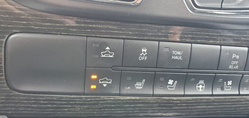

Recently purchased a '16 1500 with air suspension. Since the day I got the ride was like Cadillac. But the two lights on height adj button on dash have always been on. Now the rear end is like it's welded to the axle. I bought an obm and tests say the button is stuck. So now I know it's a tangable issue.
I guess I'll r&r the dashboard button, but any other advice or thoughts you'd like to share with me?

These two lights have been on since I bought the truck. Are they supposed to stay illuminated? Ive replaced that button assembly, disconnected the battery for hours, and have reset the air suspension countless numerous times.
Since the assembly doesnt leak air, IM leaning towards this being an electrical short somewhere. So, now my thoughts are to delete the suspension with the ODM and power the compressor & direct the air manually via mechanical control. Schrader valve mounted in back by tanks. Probably put an air dryer inline from a semi. Then I dont need to worry about nitrogen.
Any input is appreciated.
Not sure if you got this fixed. But to answer your question, in normal riding mode, yes, both lower lights should be on. If you push the button once while parked, it will lower the truck and drop to 1 light. in normal ride mode. if you push the upper one once, that will put you into offroad 1 with 1 light on. push it again puts you in offroad 2 with 2 lights on.

Thank you sir for answering.
Because I was not familiar with the complete POS that Dodge Ram calls their electrical system I decided to just completely separate the electronic controls from the mechanical equipment. So the two lights do stay on but none of that is applicable to me anymore.
