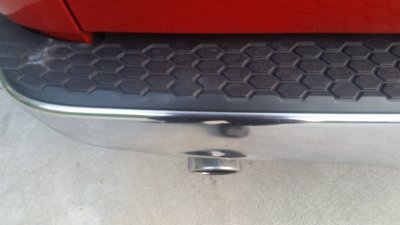

heh, it was another car in the parking garage that got my attention.
shoulda got the whole bumper, but this should give the gist of it.

Bumper looks fine to me. Not bent, no dings. Not even a scratch.
I assume it's just the bracket that got bent.
I would remove the bumper and straighten out the brackets.
If you remount it, there should be enough play in it to get it realigned properly.

yeah, it's not, it's just pushed in. so I got lucky there. gonna check out this pic above and see where the bolts are to loosen em up.
