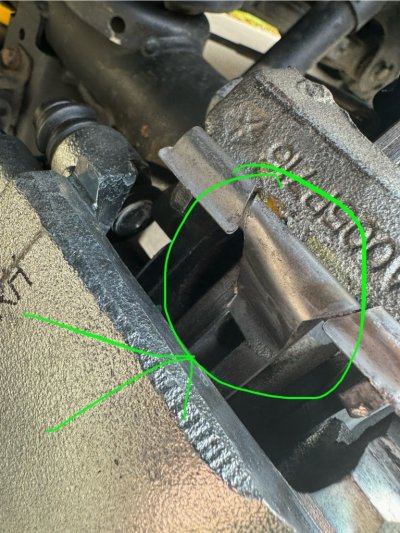

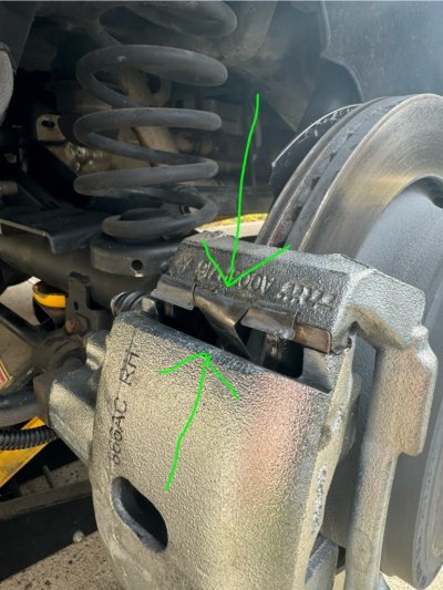

So I had my brother pick it up as I was out of state before Christmas.
From the dealership back home, was pretty much highway speeds. It wasn't until my brother hit the neighborhood streets at 25-30mph that he noticed a weird noise.
So upon my arrival home for the holidays, I discovered the noise was coming from the rear passenger wheel.
I pulled the wheel off and discovered this. I am not sure how to react or what to do, but it was very upsetting after spending a grand total of $8700 and having to repair this on Christmas day.
Last but not least, is this grove photographed below normal? Seems odd. It appears the finish wasn't worn away, so I can only imagine this is factory. I've never seen this on a rotor before. Possibly for balancing?

Groove is normal ,for balancing.
