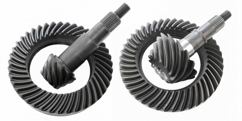

So you are letting the dealer fix it? Lets us know, because some of us would have some ideas. If you still have a choice, tow that puppy home.
I'd take this as an opportunity to get rid of tiny 3.21's and put some 4.10's on ot... The 3.21 is even taller or tinier then the small one in this photo.
A stock truck isn't going to hurt a set of 3.21's Mike.Hell i drag raced mine for the first while with a completely stock diff /3.21's and the light duty factory limited slip.The weak link is the factory limited slip,not the gears.The downsides to higher gears like 3.92's/4.10's is worse gas milege,way higher oil temps at highway speeds.With the 8 speeds stump pulling 4.71:1 first gear , deep gears aren't really needed as much as they are with the older RFE transmissions.Throw in the fact once the 3.92's shift out of first,the torque multiplication advantage is with the 3.21's that are still in first gear,and after that they swap back and forth on which one has the torque multiplication advantage. When i swapped out the 3.21's on my truck to 3.55's i didn't gain squat at the dragstrip,but at 75+ mph my milege took a $h!t kicking and my oil temps also had a noticable increase.

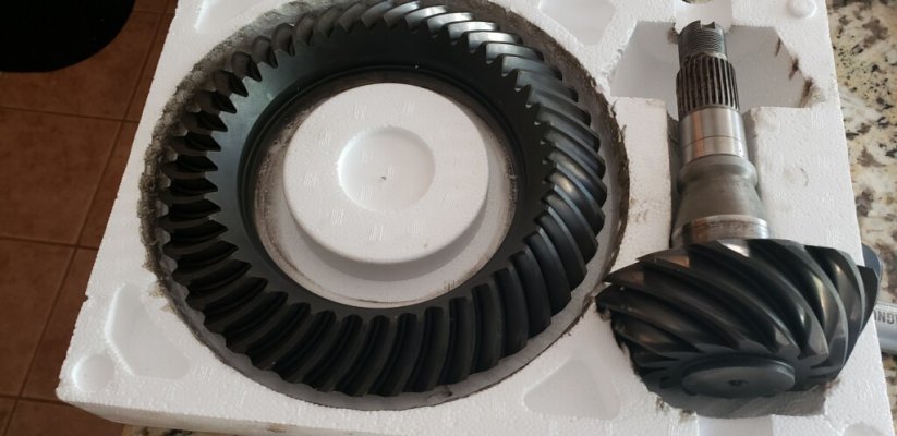

Here was my 3:21 ring and pinion after swaping out for new one for reference.
