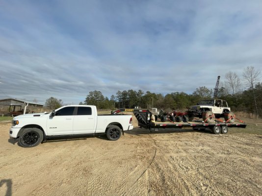

Industrial facility specifications that I've worked with for multiple operators specify personnel protection insulation be applied for surface temps of 140F or higher to a height of 6-8' elevation depending on the operator. When building a facility for the middle of the Sahara back in the late 1990s, we changed the spec to 160F or higher because pretty much everything made of metal was near or above 140F in the summer. You couldn't climb a steel ladder to the top of a vessel without gloves on or you would burn your hands. The point is that temps lower than some folks think are quite hot to the touch.
After I've installed new gears in one of my rigs, I'm meticulous with break-in which includes monitoring temps. You will usually find the highest temp when you shoot the outer pinion bearing, which makes sense since it's the smallest bearing, spinning at pinion speeds, and farthest from the oil bath. Anyway, just something to consider when shooting the temp on your diff.

Nice setup with the Jeep! Im not too far off from you.
