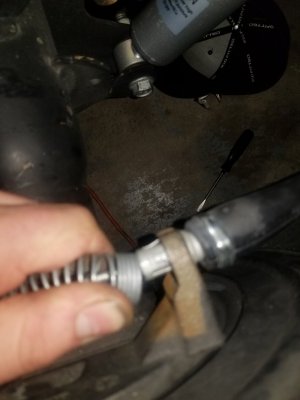

I need to reroute my passenger side rear ebrake cable. Any concerns that i should be worried about adjustment wise or anything. Or is it a simple remove and install.

Notice at bottom of where the ebrake cable goes through the rusted looking spot. I need to seperate it there. How do i go about it.

How did you do it?

Man what i did was remove wheel and jack up the truck. Then i zip tied the spring on the cable to get some tension off of the cable notice pic below. There there is 3 tabs u got to push in but really you just got to do two then twist cable to get other prong into slot. And then it came right out easy peezy. Again this was due to the illicit no cut brackets so had to modify the tab on the lines bracket which i just creased it into the hole on the illicit brackets. I could yank on it with a ratchet and it wouldnt move so worked for me.
