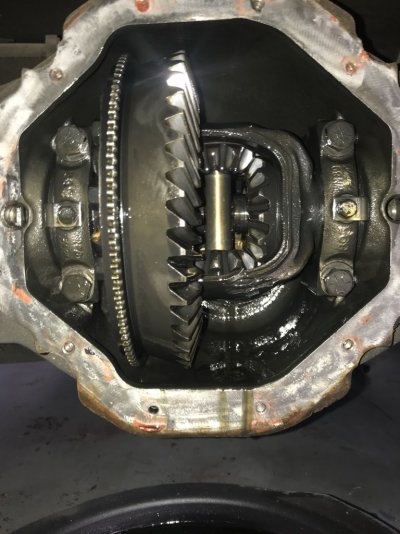

Man, I’ve been there. Violent is the word! It happened to my 03 years ago. I’m pretty sure mine slung the pinion nut.
Same diff is in the truck today (overhauled of course!) Check out the teeth marks the gears left. 51D238B5-B6E4-4981-9739-4A622E199172.jpeg

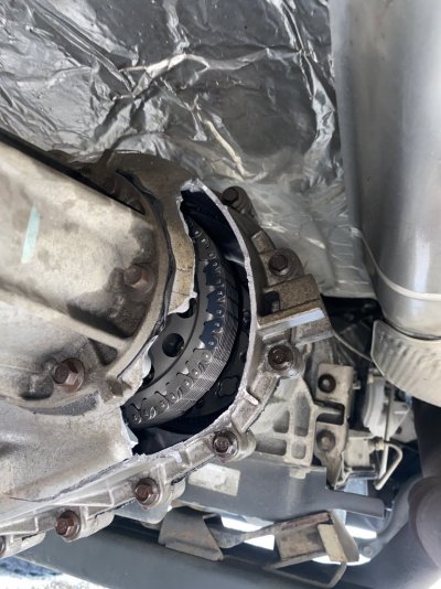

Got more pictures before getting the truck towed to the dealership. Here’s the worst side of the transfer case.

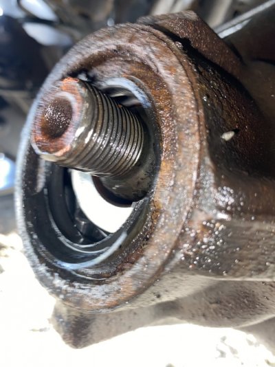

You can also see the threads on both the pinion shaft and the nut that’s still captured between the driveshaft flange and pinion flange are fine. So the only possible way for it to come apart is by unthreading.6ACE676A-9943-451F-816F-130F722792A4.jpeg

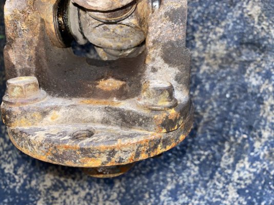

71B9B380-58A9-48E7-B2D6-A484A5867D54.jpegBA6B363E-1987-4DE4-8049-35900B184069.jpegE7350166-C853-4CB6-A543-6B651495659F.jpeg
Took pictures of the 2 flanges still bolted together so they can’t try and say anything different since the 2 clearly haven’t been separated for a while due to the corrosion and bolts not being disturbed or anything.

Man, your tk's transfer case internals look nice and clean!

Too clean, I would expect oil all over everything. You DID refill it when you changed it didn't you?
Of course I did. That picture was taken a day after everything happened so everything has already dripped out, plus as mentioned before I was driving when it happened so everything behind where the picture is taken is covered as that’s where the wind blew the fluid. Aside from that the problem didn’t start at the transfer case, it was just taken out in the process.
