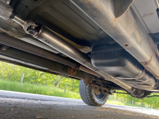

Just got a call from the dealer and my truck is finally done! They replaced the transfer case and driveshaft with oem parts, and rebuild the differential as they couldn’t find a replacement. Going to pick it up here in a few hours and will have more info as to what all was replaced and will update then.

Well just got the truck back and it drives great now. Here’s all the paper work with the parts list of what’s all been replaced. I’m very satisfied with the work they did and it seems like they were very thorough on making sure everything was done right. Best of all it costed me absolutely nothing aside from the towing fee to get it there.

Nice to see Ram stepping up on this. New pinion shaft, axles, bearings, t-case, the works! Enjoy the new truck!

Nice looking truck! Wow they really did you 'right'. You have a brand new rear diff now. and xfer case.
Considering the miles, you might want to take the axle-wind-up torque off the front driveline and push up/down vigorously on the front (inner AND outer) CV's and see how tight or loose they are. Same with the front driveshaft. Just to see how the rest of the driveline 'feels' and if anything needs attention. Check upper/lower ball joints.
