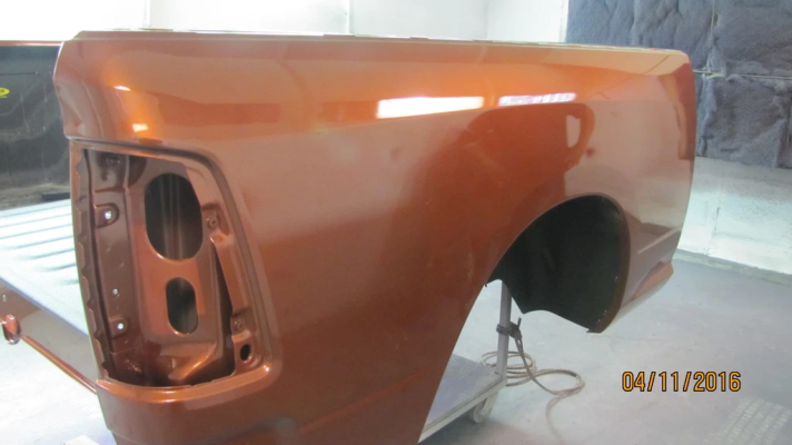

many owners run the vent line up to the underside of the bed
others remove the Left Tail Light & run the vent tube into that cavity.
