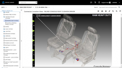

I have a 2015 RAM 2500 SLT Mega Cab. I added Laramie heated/ventilated/memory seats from a 2015 Laramie. I am trying to add the rear heated seat option for the kids. I know this will be a project and I need quite a few parts. I am curious if you can help me out with the following, and maybe some I don't know of:
Module w/rear heated seats option:
Harness under the drivers seat with extra wires:
Rear elements:
Wiring:
I already have the rear center console with buttons, and the wire harness that goes from the buttons to under the seat. The harness under the seat that I need is the one that actually connects to the seat.
Any help would be greatly appreciated.

It may be required to add the code JPZ after all of the hardware is installed. The codes typically are added into the BCM which then activates the circuits. Regardless of which module its added to I would plan on doing this.
Yes I will send you a code.
Sorry I do not have photos but that is all I show for rear seat wiring. The diagram image may not be 100% accurate but its what I am working off of.

From what I can see the front seat harness is responsible for carrying circuits to the Rear Switches
The body harness then is responsible for bringing the circuit to the rear seats

We are at about 420.00 with the rear pads and wiring only. The front seat harnesses and switches are needed from what I can see as well as the body harness which carries the wiring rearwards based on the schematic I included above. I would sit tight and wait for wayned87's findings.
