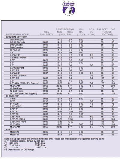

tons of YouTube videos on how to do i properly. Dont be a hack and just count threads. :banghead:
While I agree with your approach, Ii believe that chart is for The pre load on the pinion bearings ONLY, to be used when setting up new gears. IE: it does not allow for the differential, Axles, their bearings or brake drag :( :cheers:
