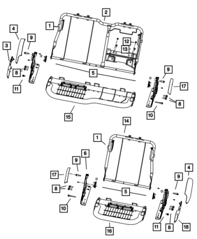

Hey guys, My 2006 ram 3500 rear seat on the right side has that middle section with it too. Would I be able to remove that and swap a single seat like whats on the left side in?

Frame set up would need modifications, look underneath and measure the single seat framing and reverse the measurements for the other side, and make sure nothing is underneath outside where you need to drill. But it isn't finished underneath so you need to pretty it up if you are planning to have "bucket seats" back there.

I would say no.
If there was a middle support under the 60 then I would say yes.
