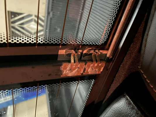

Hello, I bought a 2020 Rebel and the rear sliding window has some broken parts. You can hear the motor but the window does not move. Previous owner said that it got stuck and the forced it. Anyone has the diagram so I can figure out what I need? Thanks, ugly picture attached.

I’ve read that you can only change the whole window out, no parts sold separately. I might be wrong but that’s what I’ve read.
When the replaced my Rear Slider Window due to cracked frame, 2 places, it came as a Complete Unit: Rear window, entire slider assembly and control box and wiring.
Backlite Glass - Mopar (68402761AA)​
