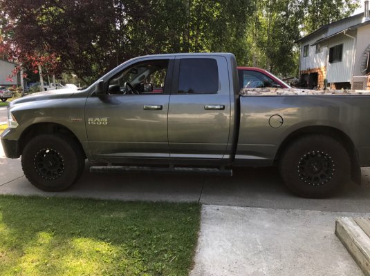

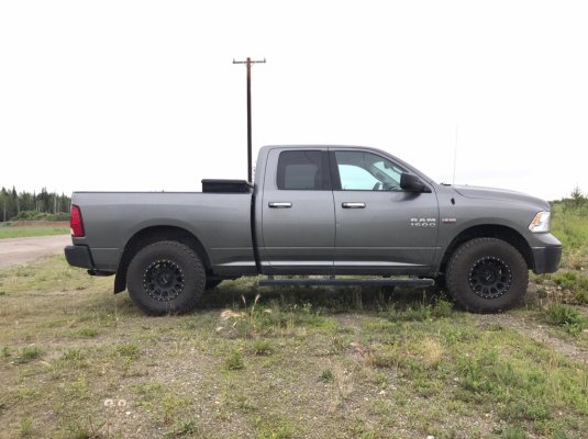

I felt the same and ended up getting some 1" TGC spacers. 2.1 up front as well
Loaded up with about a half cord of white birch
Unloaded
