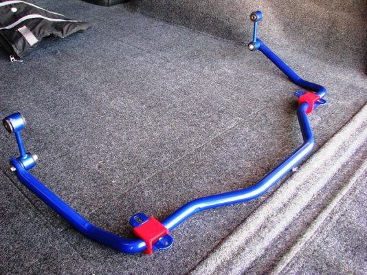

Thats different? seems to mount in reverse of the Hellwig wiith the direction of the bar and has different mounting points. I will revisit this myself as I was about to pull the trigger on the hellwig and Magnatec Cover (Moes).
HemiLonestar
Navy Badge Coast Guard
Jun 1, 2012
6,809
4,686
MD
Hellwig doesn't mount like a factory bar would. Addco, Belltech and Hotchkis rear bars mount like a factory bar would (normal 1500's 02-08 never got one, only SRT-10's).

That belltech kit looks pretty slick!

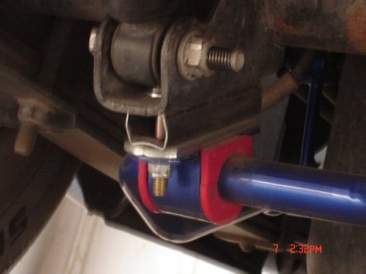

Brought it from Moes 5-6 years ago at a great price as it was a "Get rid of inventory" sale.
I had to add 1" spacers to extend the bar away from the pumpkin as it was almost touching while it was on jacks. Could be due to the 4/6 setup.
Hellwig would be the best choice for you if you are going with the Mag-Hytec Differential Cover
If only the Hotchkis TVS setup was still in production.
Pic of the spacer
Belltech 5555
