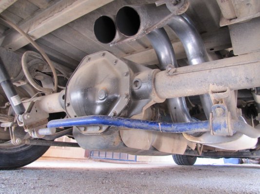

Trucks with the towing package came with the swaybars. My truck has the front and rear set (wifes did not when we got it), and between driving my truck and the wifes there is a sight difference.

My 06 has a tow package but no rear sway bar.

Not on any 3rd gen 1500 I've ever seen.
