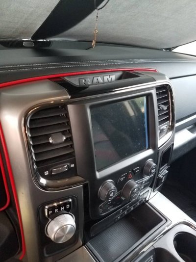

Few interior shots. All four doors one piece. Few pieces around dash. Basically just test fitted it and where the fitment was good was where it went. Some of the cracks are just too big for the seat cord to fit snug.
-Trav
Everything for the most part is easy, but how did you mange to do the center console around the radio? I can't get it to look as clean as the pictures? Having issues towards the top.

If I can remember correctly that was a tough spot. Did u try like flipping the cord where like the flange is the other direction I did that in a few spots and I think it snugged it up better instead of it wanting to pop out.
