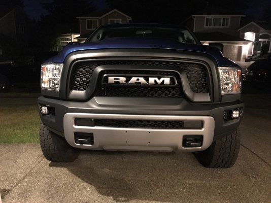

I swapped the front bumper on my slt for a rebel bumper and need something to fill the fog light holes. Anyone have any input on how well the fog lights work on the rebels? A pair of factory fog lamps will cost $400. For that price I was thinking about a couple led pods on each side. Thanks for the help.

Yeah, I was kinda surprised someone hasn't made an upgrade kit or even a bracket to fit something different. I just picked up a pair of 3" rigid cubes. Hopefully I'll have time tomorrow to try and fit a square peg in a round hole.

Got a chance to get a little work done tonight. Installed a pair of Rigid led cubes. Trimmed out the bezel a little and made a couple small brackets. I'll get them wired up tomorrow when I install the 20" led bar below the "RAM". Didn't turn out too bad.

Finally got a little more time to work on it this week. Got the fog lights wired up. The suckers are pretty bright. Kinda wish I went with the road legal ones they make because I added a 20" bar for off-road lighting.

Cool MOD. Just a thought, you could wire the bright fogs to your high beams and/or light bar and then install a second set of fog light pods triggered by the fog light switch that are street legal. It looks like you might have the room for it.

That's a good idea. Keep these for brights and just add another pair.

Looks great. Is the light bar curved or straight? Got any side pics? Looking at doing a aftermarket rebel grille and would love to add another LED bar. But the one I like only comes in straight and worried about it poking out too much. Want to see how you mounted it too if possible.

It's just a straight 20". It sticks out a little but not too bad. No more than the bumper. Might be able to get it in closer if you made some different mounts but I thought it looked good and wasn't feeling that ambitious.
