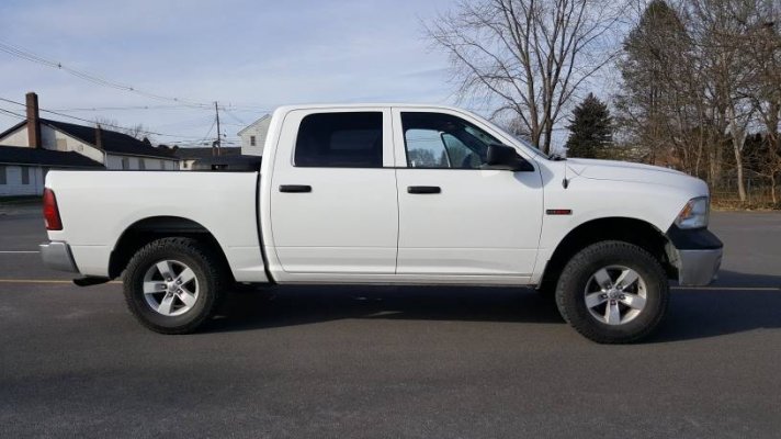

Pic is of my truck, stock wheels, 285 70s. 74d8cfa97446046af5fffe7e88aecbd1.jpg

I have a 2018 Express 4x4 with the rebel wheels LT285/70r17. They stick a little further out then my 20s.
