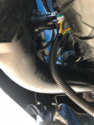

Something of a dated reply but... So..I got the wiring mod done...and no I did not remove the spare tire to gain access for the plug disconnects and re-connect of the expansion harness. My 2018 only has 10600km's (6000 approx. miles) so the plugs all came apart without issue. Spent a bit of time mapping out a wiring route to keep things tidy. That took longer then the plug-n-play install. I dosed all the connections with K7-Krown lube to ensure they stay corrosion free. I also upgrade the bulb in the "RAM" logo receiver hitch light unit to LED. This works much better as a (hopefully) fourth brake light device to help keep them dough heads out of my ass end at stop signs and red lights. It is also more in keeping with the "instant on" lighting that the OEM brakelights exhibit . Very please here.
