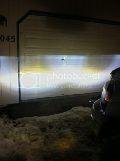

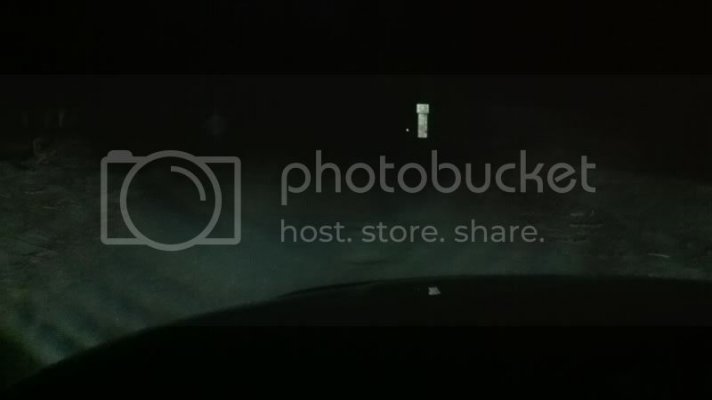

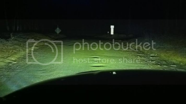

I got a set of recon projectors for a killer deal, and cant figure the HIDS out. Its really starting to **** me off. Lets start by saying, The wiring is good and everything. The lights work GREAT, its the housings and light output. I originally had H1s, what recon calls for, in them. The pattern was horrible and light output was minimal. My fogs were doing most, if not all, of the work. One day i noticed that if i pulled the H1s out slightly, the pattern cleared and voila! Good to go. So i got some H3s. They went in and were actually cut off by the projector, but once again the pattern was terrible. They look great close up, but as you can see, they create U shaped patterns. Meaning as soon as there is any distance between me and an object, they end up way off in the ditch with almost no light in front of me. I have tried to contact recon with no help. This is so frustrating and any help is appreciated. Attached is some pictures. (I put the h1s back in and did NOT aim them. This is just a beam pattern reference picture)

Yea, something is most definitely wrong.
Is the beam pattern all messed up with halogen bulbs?
It seems like the bulb is out of the foci of the parabolic reflector.

It means that the filament (or arc tube) is not sitting in the correct spot on the projector housing. That's why you are getting such a strange light output from it.

Wow those projectors have a terrible cutoff

Here's the problem.......
Recons use cheap **** HALOGEN projectors. This is the result when you put HIDs in a projector that is not designed for HIDs.
If you like the look of the Recons, best bet is to swap the ****** projectors for some that are made for HIDs, or better yet.........retro your stock heads and have a custom set that the truck next to you at the stop light doesn't have. :D
