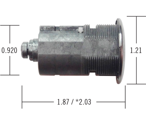

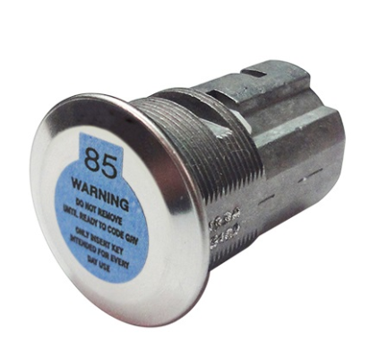

the company he mentioned for Lock Parts is
i used my 2016 Ram to find a cylinder at BOLT Lock
BOLT Lock Cylinder Dodge/Jeep/Ram​
STAINLESS STEEL LOCK SHUTTER- MSRP $19.99​
Part # 692916​
Fits​
Dodge, Ram, Jeep & Chrysler Keys

I have 2 Bolt products. I have a locking hitch pin and a locking coupler pin. The Bolt products are great: insert your Ram key 1st time into the cylinder turn and the cylinder pins set to you key. Great product. Might work for OP on his management divider.
