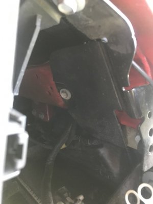

So I was looking in the engine compartment and was thinking of mounting the relay box to this bracket directly in front of the pdc. It is a steel bracket with 3 bolts holding it in and nothing mounted to it.
Is there any reason not to mount the relay box to it? I’d obviously have to drill into it.
ramrocker
Oct 22, 2017
193
111
Pearland, TX
6.7L CTD
That spot should work. I've got power steering & washer fluid tanks mounted to that bracket.
It’s a great location, that’s where I mounted my power distribution box for my AEV switches
