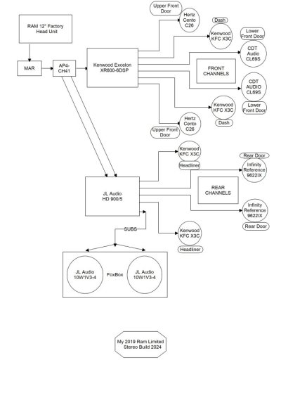

I did something similar - swapped out most of the components from my 3500 Dually to my 1500, but kept the 12" factory head unit as it plays 24bit 192khz flac files. Here's the layout - the KFC-X3C's in the dash are crossed over to produce midrange, and the ones in the rear head liner are crossed to produce highs. The tweeters in the front doors have had pods attached to plates that are centered in the grill openings for better dispersion. (may move them to the "A" pillars, not sure just yet). All the work was done with a buddy of mine who is a certified installer and myself. I won't go into the cabling and distribution blocks as everyone has their fav's. So - here's the basic layout:
211,262
3,064,205
171,514
