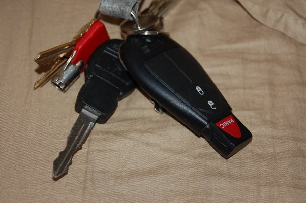

Dealer doesn't have to do the keys, some locksmiths also carry the special programmer. I bought K Fobs off Ebay and had a locksmith program 3 of them for me. 2 key fobs and a chip key that also opens doors. The K fobs were dirt cheap, like 25 bucks off ebay and they work great, the chip key was 45 bucks from locksmith and it worked great too, the cost of the programming was somewhere around 75 bucks. These are my keys, if the kfob breaks the chip ket will start the truck and can also open doors and tailgate.

This is exactly what I did, except I bought the key from the locksmith. The key w/ programming cost me $50 and works great. As for remote start, I remember seeing someone on here talking about a setup on eBay that was around $80 and takes 30 minutes to install yourself. It was on this site, so do some digging around. If I remember the name, I will let you know.
