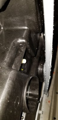

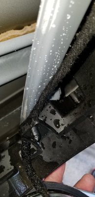

So I decided to swap my trucks door speakers yesterday. I removed the rear door panel. Everything seemed normal. Went ahead and removed the 6x9 and was just so surprised by what I found. Not in a good way. The speaker had water drops all over the back of it. I could not believe it. Checked inside door and it found water inside of it as well.
Removed the other rear panel and found more water on back of the speaker and inside the door. I then removed the passenger door panel and found the same thing. Water everywhere...rear of speaker and all over inside of door. It rained quite a bit earlier yesterday morning. I was only able to work on the drivers door this afternoon. It was pretty hot today and it was dry. It rained pretty hard early this evening again. .. just thinking about the inside of my doors and speakers being all wet just infuriates me.
How is this even possible. I have maybe 4500 kms on the clock. Brand new 2019 Ram 1500 Sport. Anybody else experience this. How did you go about remedying this mess.

Update on my posting:
Called FCA this morning and opened up a case file..just in case. Then called the service manager at my dealership. He said to me that I have nothing to worry about. I was not convinced with his
explanation. Next I called a guy who performed some leak tests on my 2016 Ram 1500. I, by accident found some wetness in my rear headrest while detailing my seats. He found a pin hole in the rear glass behind the top rubber seal. So I called him and he said to me that those vehicles were designed like that. He said the doors are considered a Wet Zone and the glass is not waterproof to the outside elements. Water runs down the glass and drains down the inside of the door and out the bottom of the drain holes. I still find it crazy it wets so much of the door channel. He said I can purchase a basket for my speakers to protect it from getting wet. The service manager said to make sure that the drain hole tape has been removed at the factory. I will be checking the bottom of the doors.

Being a stereo installer for 15 years, this is a normal sight. The water runs down the window and into the door, the window seal isn't water tight, but is more of a guide.
The water will / should drain down inside the door and out of the drain holes along the bottom of the door panel then to the ground. If the drain holes get plugged then the door will start to fill ( i usually check mine with a piece of wire 2-3 times a year )
Now if the water was in the from of the speaker then you have a problem.
Not sure about our trucks, but most vehicles will have a little hood over the speaker to guide the water away from going inside the voice coil.
Take it for what its worth, but I wouldn't be worried about it. Especially since you mentioned it rained earlier in the day. But this is yet another reason to undercoat the insides of the door panels. If fresh rain water can get in there, so can't salty rust causing water.
