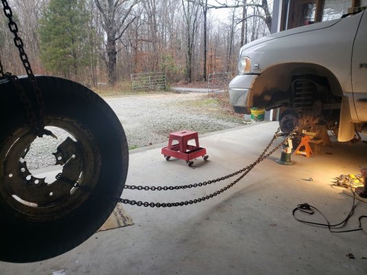

The status of the truck is that I put everything back together without getting the driver side hub off (and never tried the passenger side). I applied as much heat as I could with the simple propane/butane torch and burner I have. I tried the power steering method to the point of deforming a socket and 3/4" drive extension. I couldn't use my air chisel as my big shop isn't set up yet and the big air compressor is still in storage. I did bend 2 large chisels beyond usefulness hitting them with a 4 pound hammer. I stripped one 3 point puller. I constructed a 65 LBS 'slide hammer' using a hanging tire - per the suggestion of a retired heavy equipment mechanic in the area. Swinging this from a height of 8 feet over 100 times just shifted the front end of the truck a 1/2" or more on the concrete.
I've beat it, heated it, yanked on it, sprayed it and pried on it for a week. Monday morning it gets towed to a shop that works on a lot of diesel trucks. I guess I know where my $600 stimulus check is going. Appreciate everyone's help. As my dad used to say, "Anything you can throw money at really isn't a problem." Guess I'm going to throw some (more) money at this one. Thank everyone.
