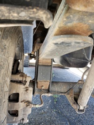

I recently bought a 2011 2500 SLT 4x4 gasser that has at least a 7 in lift on it maybe more. I like how it looks but since I load a lot of stuff into the back of my truck that high of a lift makes it real hard to load. I was looking at the blocks in the back and it seems that along with the standard lift blocks someone stacked three plates on top of the block. Could I remove those plates and leave the block without severe repercussions to the way the truck drives or the suspension? The back is a little higher than the front currently so I don't think it will make it look like the truck is over loaded if I just removed those plates. Tell me what yall think. 20190627_143557.jpg

Yes you can remove them without any harm. You will need new u bolts
