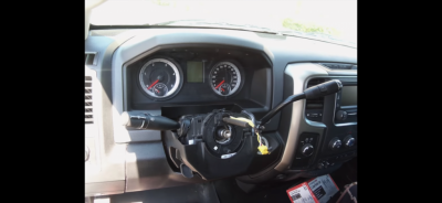

I’m scared to pull the steering wheel off. I did it before to add the Bluetooth buttons (back in 2016 or so). I was nervous as hell then and I just don’t want to risk it again. Partly cuz my cruise control buttons have been finicky ever since then.

The only scary part I remember was pulling the airbag and if you buy the tool for that it's pretty easy, just be careful with the clock spring.

I had the same kit as OP and the volume never worked right so I installed steering wheel controls and eventually replaced the whole HU with a pioneer unit. OP I was hesitant to remove the steering wheel but there are some good guides out there. To prevent your clockspring from moving around there’s a trick where you stock a pin into a guide hole and it prevents it from moving while you work. Also the airbag removal tool seems like a silly purchase but it had me popping the clips with no struggle.

I don’t even remember how I did it the first time but I do remember being very Nervous about messing up the clock spring.
