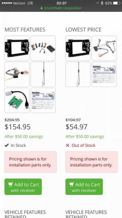

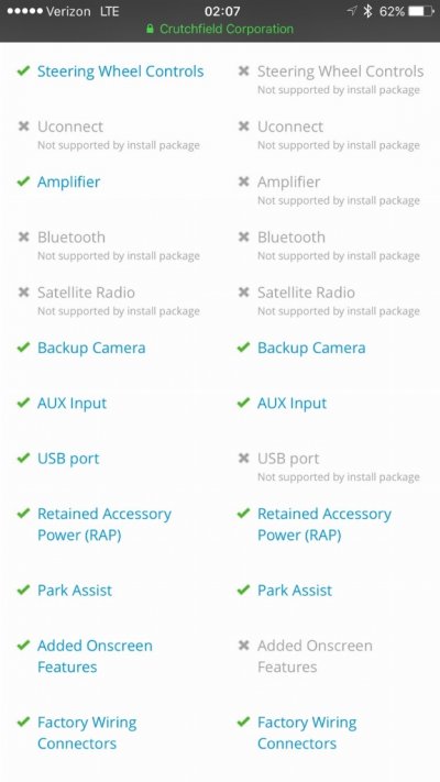

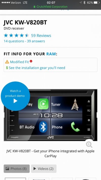

This is the radio I'm looking into with setup. b48912ac2bb9af34118f26a505e4a20d.jpg4376e9b3aa3d3c3ee5ad1500e76e377a.jpg01b66c29293edeb9c3bd1d3da2e4898c.jpg

Went to some stores today I went ahead and ordered from crutchfield that same unit that I posted above the the highest kit so I can retain steering wheel controls and my center console USB and aux inputs. I'm just hoping the installation goes smooth. They say I have to cut the lower bar on the radio support. Was trying to figure out the best way to do this
